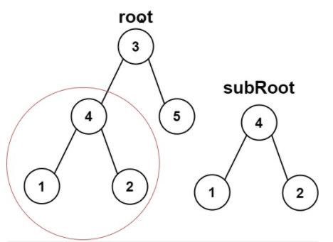

示例1:
输入:root = [3,4,5,1,2], subRoot = [4,1,2]
输出:true

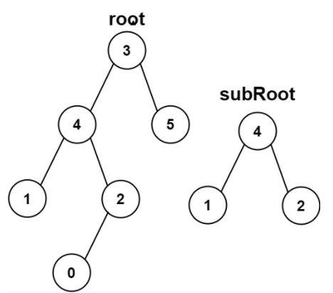

示例2:
输入:root = [3,4,5,1,2,null,null,null,null,0], subRoot = [4,1,2]
输出:false
