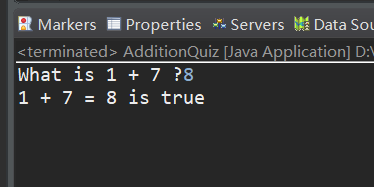

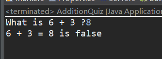

1.2、随机数加法程序
通过程序产生随机数让一年级学生练习加法。程序随机产生两个一位整数,number1 和 number2,然后显示“What is 1 + 7?”
package program3_1;
import java.util.Scanner;
public class AdditionQuiz {
		int number1 = (int)(System.currentTimeMillis() % 10);
		int number2 = (int)(System.currentTimeMillis() / 7 % 10);
		Scanner input = new Scanner(System.in);
		System.out.print("What is " + number1 + " + " + number2 + " ?");
		int answer = input.nextInt();
		System.out.println(number1 + " + " + number2 + " = " + answer + " is " + (number1 + number2 == answer));

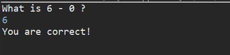

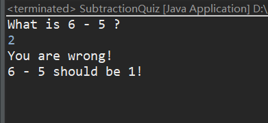

2.2、随机数减法程序
一个让一年级学生练习减法的程序,程序随机产生两个一位整数 number1 和 number2,且满足 number>=number2。显示问题:“What is 9 - 2 ?”学生输入答案后,显示消息判断是否正确。
package program3_3;
public class SubtractionQuiz {
		int number1 = (int)(Math.random() * 10);
		int number2 = (int)(Math.random() * 10);
		if(number1 < number2) {
			int temp = number1;
			number1 = number2;
			number2 = temp;
		System.out.println("What is " + number1 + " - " + number2 + " ?");
		if(number1 - number2 == answer) {
			System.out.println("You are correct!");
		else {
			System.out.println("You are wrong!");
			System.out.println(number1 + " - " + number2 + " should be " + (number1 - number2) + "!");
