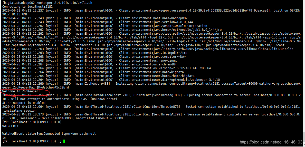

1. 启动客户端
[bigdata@hadoop002 zookeeper-3.4.10]$ bin/zkCli.sh
  • 1

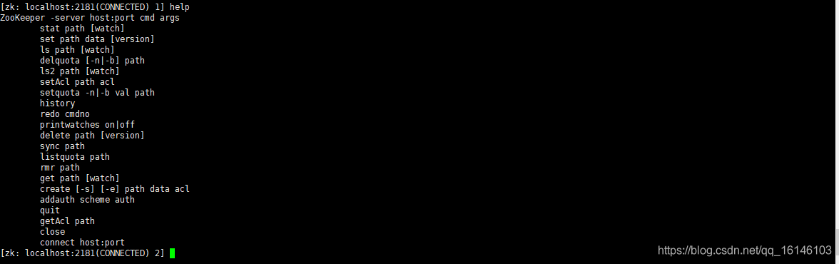

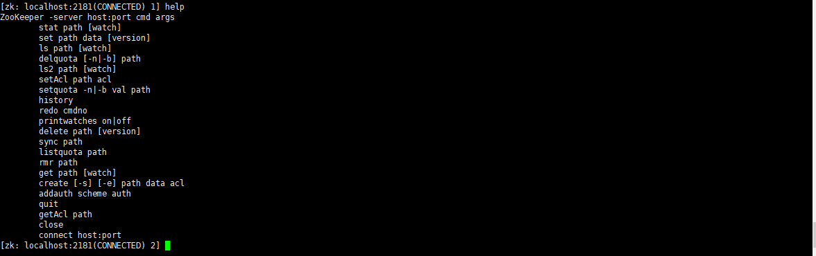

2. 显示所有操作
[zk: localhost:2181(CONNECTED) 1] help
  • 1
  • 2
2

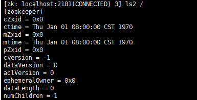

4. 查看当前节点详细数据
[zk: localhost:2181(CONNECTED) 3] ls2 /
  • 1
4

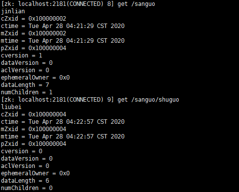

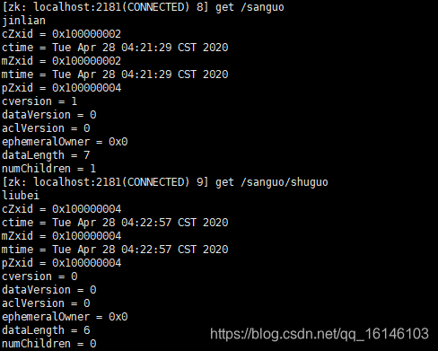

6. 获取节点的值
[zk: localhost:2181(CONNECTED) 8] get /sanguo
[zk: localhost:2181(CONNECTED) 9] get /sanguo/shuguo

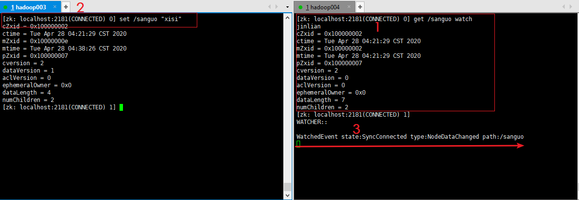

10. 节点的值变化监听
  • 1. 在hadoop004主机上注册监听/sanguo节点数据变化
[zk: localhost:2181(CONNECTED) 26] [zk: localhost:2181(CONNECTED) 8] get /sanguo watch
  • 1
  • 2. 在hadoop003主机上修改/sanguo节点的数据
[zk: localhost:2181(CONNECTED) 1] set /sanguo "xisi"
  • 1
  • 3. 观察hadoop004主机收到数据变化的监听
WATCHER::
WatchedEvent state:SyncConnected type:NodeDataChanged path:/sanguo
  • 1
  • 2
  • 4. 图解
    8

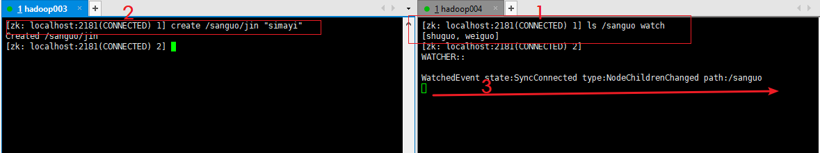

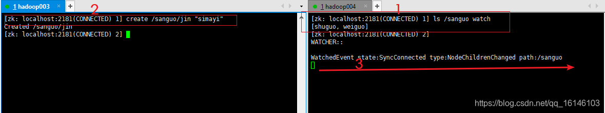

11. 节点的子节点变化监听(路径变化)
  • 1. 在hadoop004主机上注册监听/sanguo节点的子节点变化
[zk: localhost:2181(CONNECTED) 1] ls /sanguo watch
[shuguo, weiguo]
  • 1
  • 2
  • 2. 在hadoop003主机/sanguo节点上创建子节点
[zk: localhost:2181(CONNECTED) 2] create /sanguo/jin "simayi"
Created /sanguo/jin
  • 1
  • 2
  • 3. 观察hadoop004主机收到子节点变化的监听
WATCHER::
WatchedEvent state:SyncConnected type:NodeChildrenChanged path:/sanguo
  • 1
  • 2
  • 4. 图解

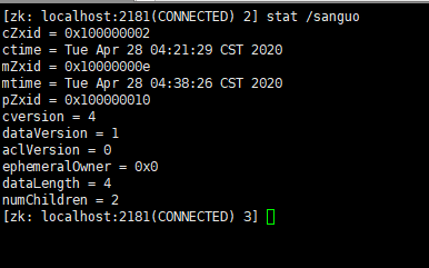

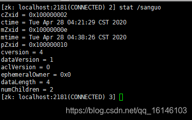

14. 查看节点状态
[zk: localhost:2181(CONNECTED) 17] stat /sanguo
