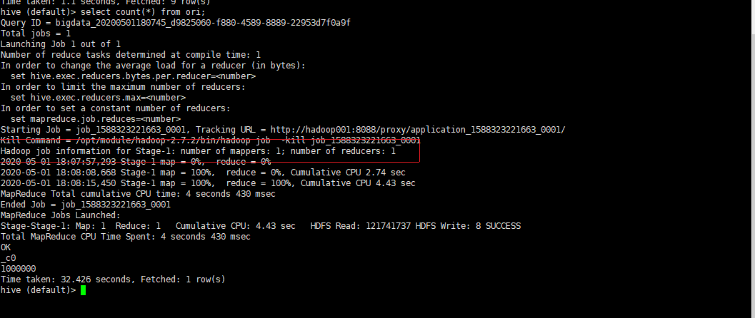

  • 1. 执行查询
hive (default)> select count(*) from emp;
Hadoop job information for Stage-1: number of mappers: 1; number of reducers: 1

  • 2. 设置最大切片值为100个字节
hive (default)> set mapreduce.input.fileinputformat.split.maxsize=100;
Hadoop job information for Stage-1: number of mappers: 6; number of reducers: 1
