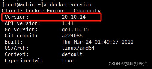

 - 3:检查是否安装好docker
[root@aubin ~]# docker version
Client: Docker Engine - Community
 Version:           20.10.14
 API version:       1.41
 Go version:        go1.16.15
 Git commit:        a224086
 Built:             Thu Mar 24 01:49:57 2022
 OS/Arch:           linux/amd64
 Context:           default
 Experimental:      true
